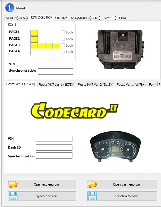

Supported cars:
Ford Transit Connect 2005-2010, Ford Fiesta 2006-2009, Ford Fusion 2006-2009, Ford Mondeo 2008+, Ford Galaxy 2008+, Ford S-max 2008+.
Supported ECUs:
SID804, EDC16, SID206, SID202, SID803, SIM210.

Read the instrument cluster EEPROM using CarProg OBD2 or you can remove the IC from the car and read the HC12 processor EEPROM using any programmer like CarProg, XPROG, or UPA, save the file and open it with "Open IC Dump". The program will show you the transponder data. Write this data to the EH2 or TPX2 transponder using any transponder programmer such as RW4, Codereader or Zedbull.
If the immobilizer light is on, the engine ECU is faulty/defective:
Open the ECU (SID804,EDC16,SID206,SIM210) and read the EEPROM (with CarProg you can read the circuit contents). Open the file with the "Open ECU EEPROM" button. Now click the "Synchro to ECU" button (if you want to transfer data from the dashboard to the ECU) or "Synchro to Dash" (if you want to transfer the data from the ECU to the dashboard) and write the saved file to the dashboard (if you synced to the dashboard) or ECU (if you synced to the ECU).
